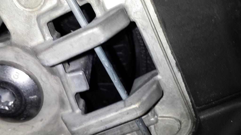

Unhook the airbag from the steering wheel.
To do this you will need the flat head screwdrivers. They are latched on to one of these either side.
Its very awkward to get to, but you have to slide the metal bit away from the hook on the airbag, while pulling the airbag from the front.
This is where the downside of disconnecting the battery comes in. This is because you need to turn he steering wheel to either side to get to the clips.
Once the the airbag is loose, be careful as there are wires attached to them.
