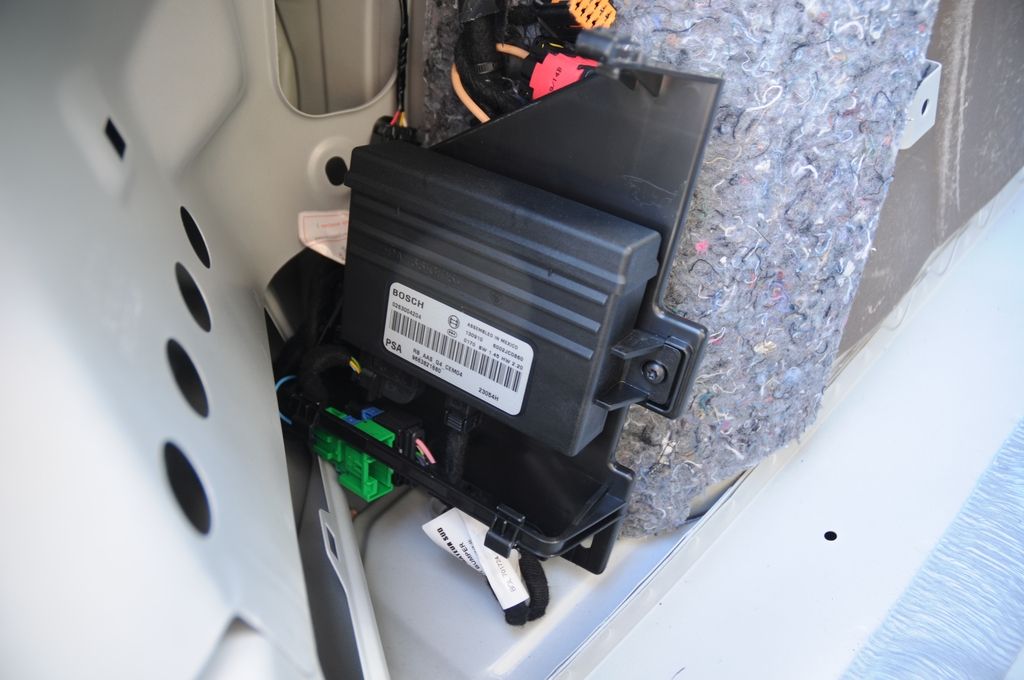

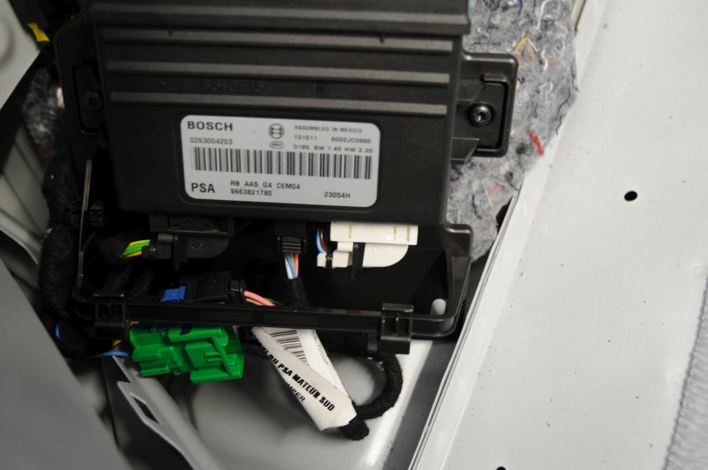

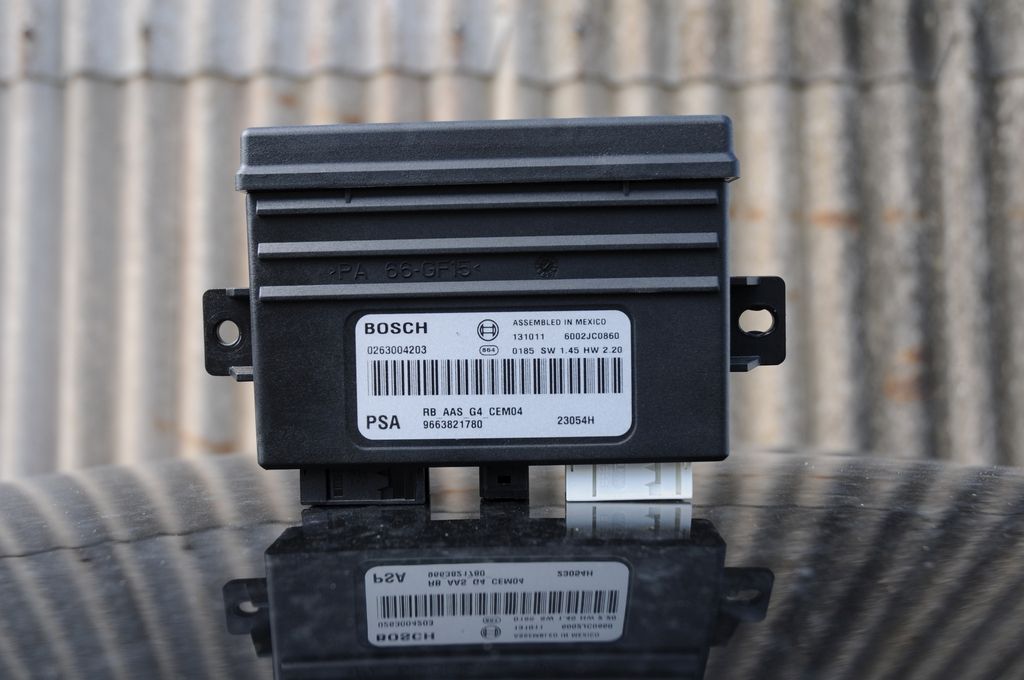

As some have said here, the sensor ecu is in the boot on the l/h side near rear light. It can be reached through the little door in the boot paneling, but I took the whole paneling off. The chrome D ring was held on with a torx screw behind a plastic cover.

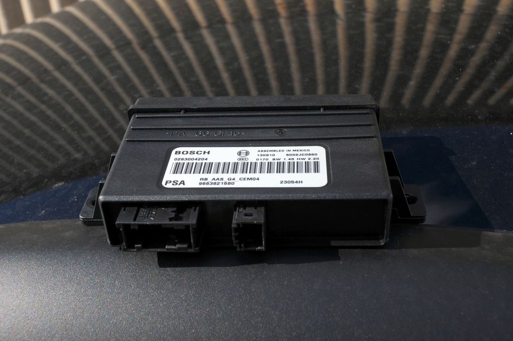

This is the ecu for front and back ( 8 sensors )
This is the rear only ecu ( 4 sensors )

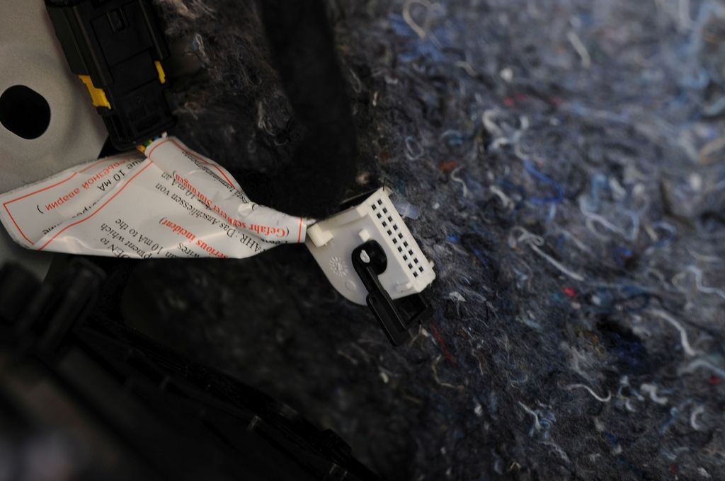

In the rear only the spare connector is in the loom ( here in white )
rear only ecu ( no connector on right )
front and rear ecu with extra white connection
part number of f+r ecu

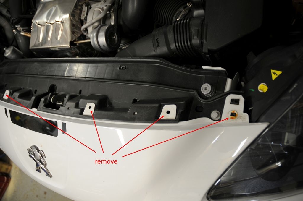

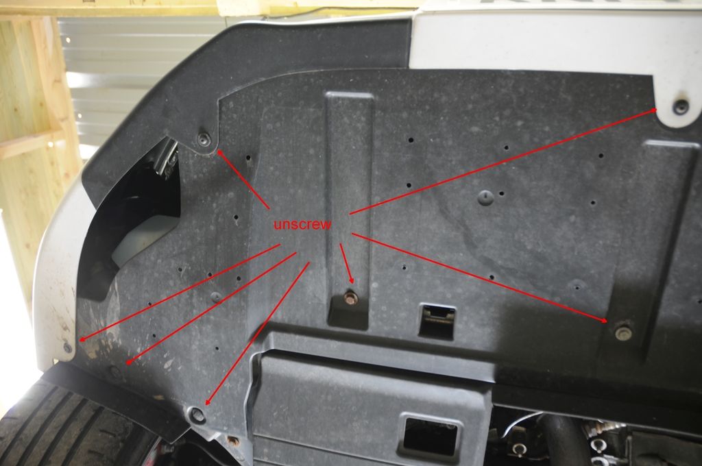

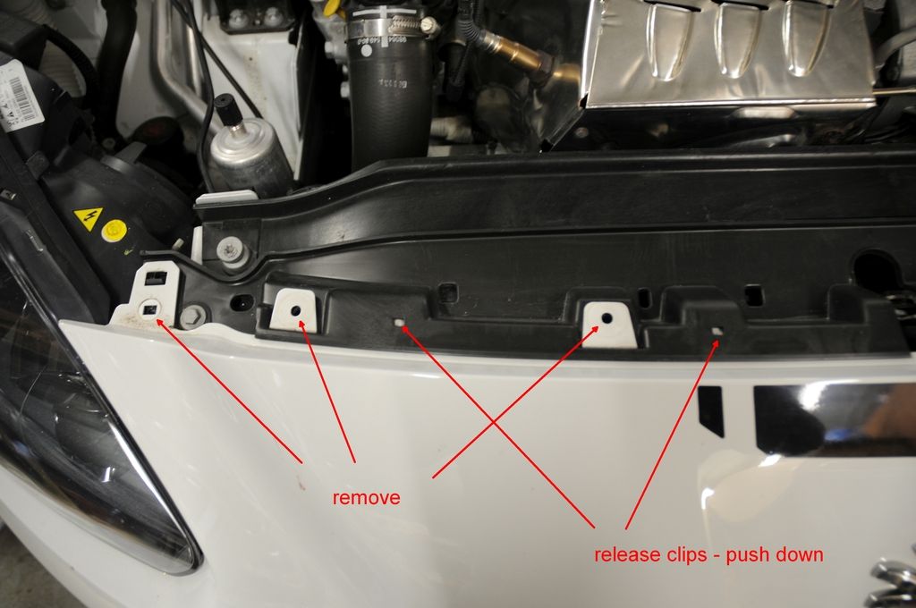

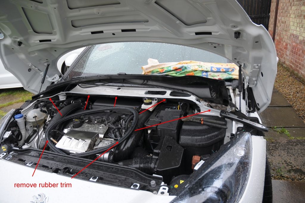

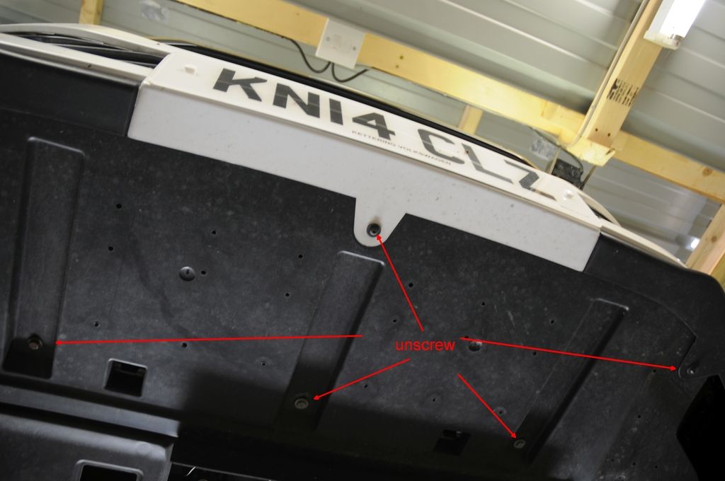

remove the following screws nuts plugs etc

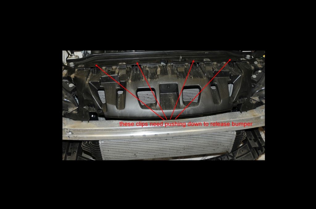

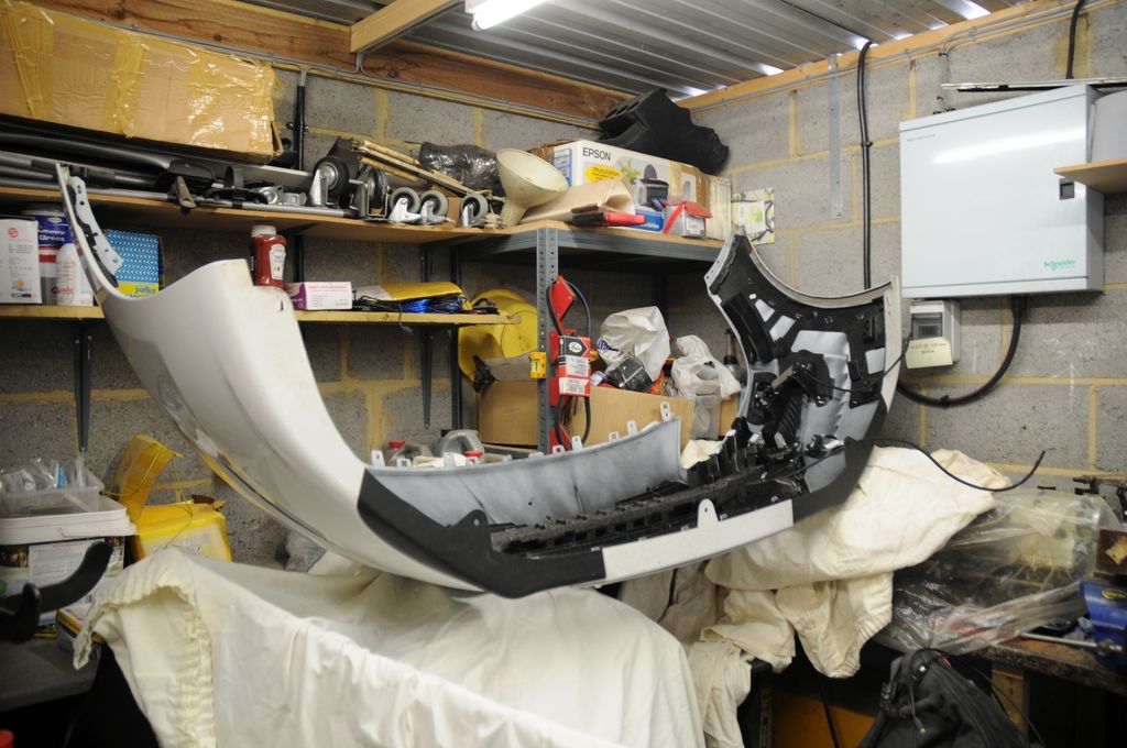

Its worth noting at this point that the bumper is held by four push clips which need to be released, and the bumper is a very tight fit, and feels like it is held in the middle of the bumper somewhere - it is not, it's just a bloody tight fit !
Bumper removed

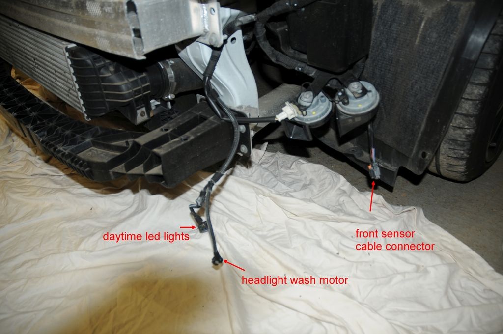

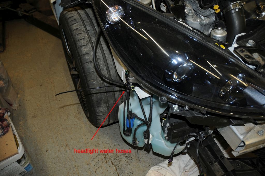

The water connections just pull out carefully, but you need to fasten them up to stop the screenwash draining.
unplug led lights and headlight wash motor

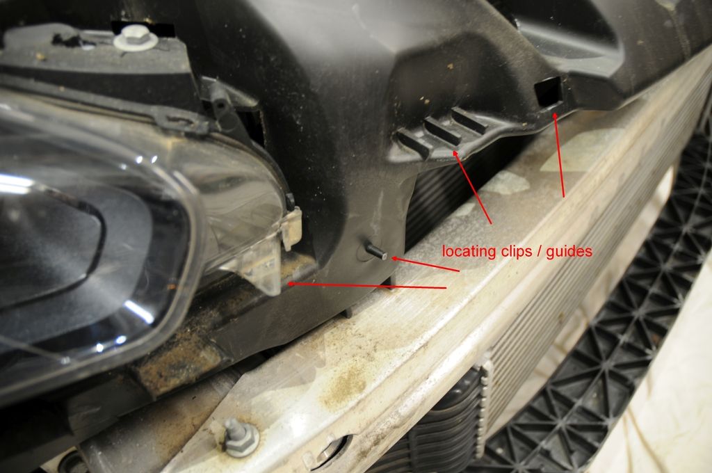

guide points
push clips
here as seen from the r/h side - note the connection for the front sensors is in the harness and sits inside the bumper on a push clip - no need for additional cabling

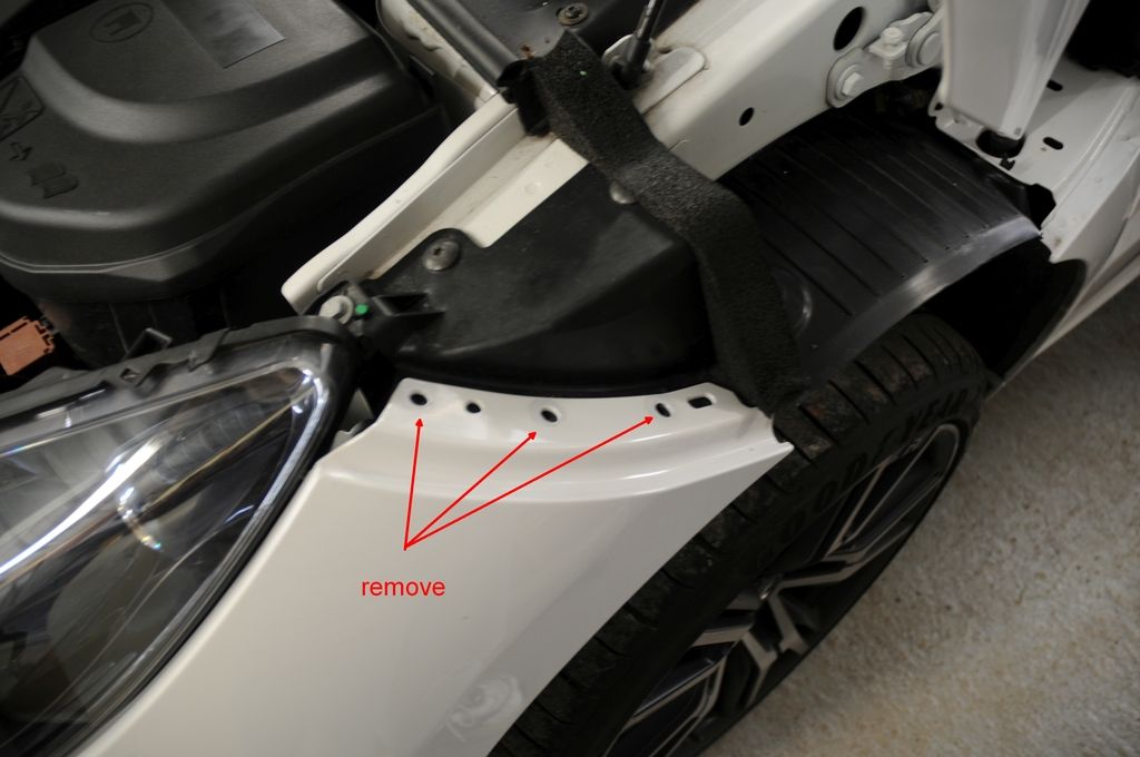

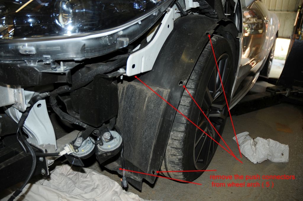

wheel arch push clips, 5 need removing before bumper release. this is one of the first things to be done, but this was the best picture and it is out of sync - sorry.

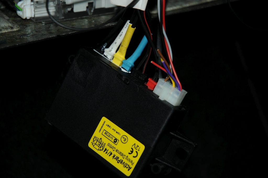

this is the after market front sensor control system as fitted by Peugeot - cables cut are for display I think.
A live and neutral feed taken from here, only live when ignition on

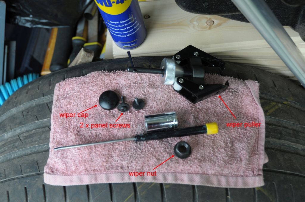

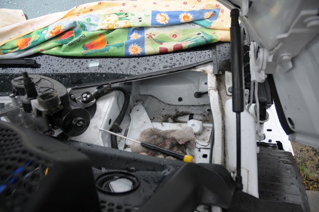

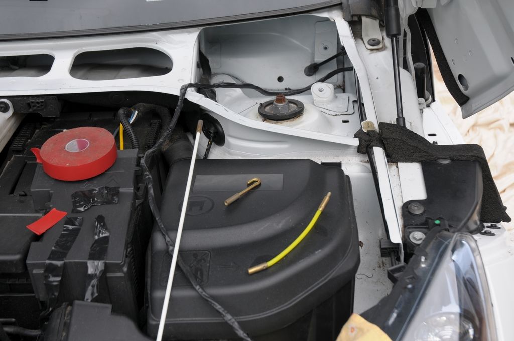

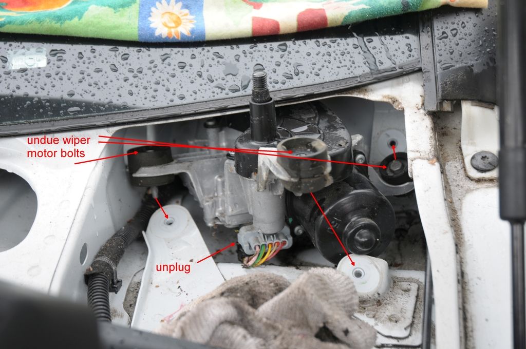

wiper motor on r/h side needs removing and it's a bitch.

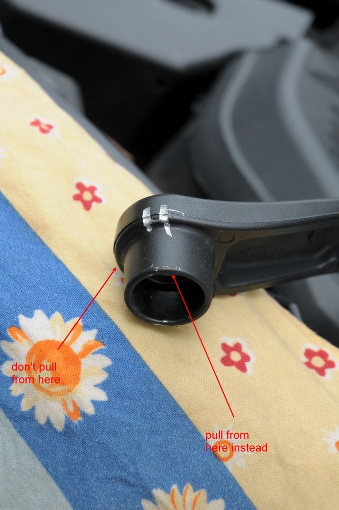

needed to remove wiper arm from motor - this was the bitch bit.

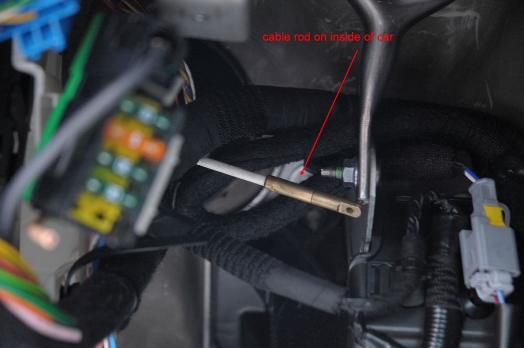

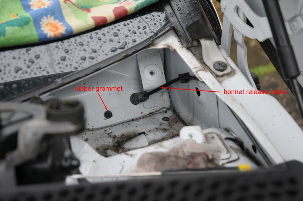

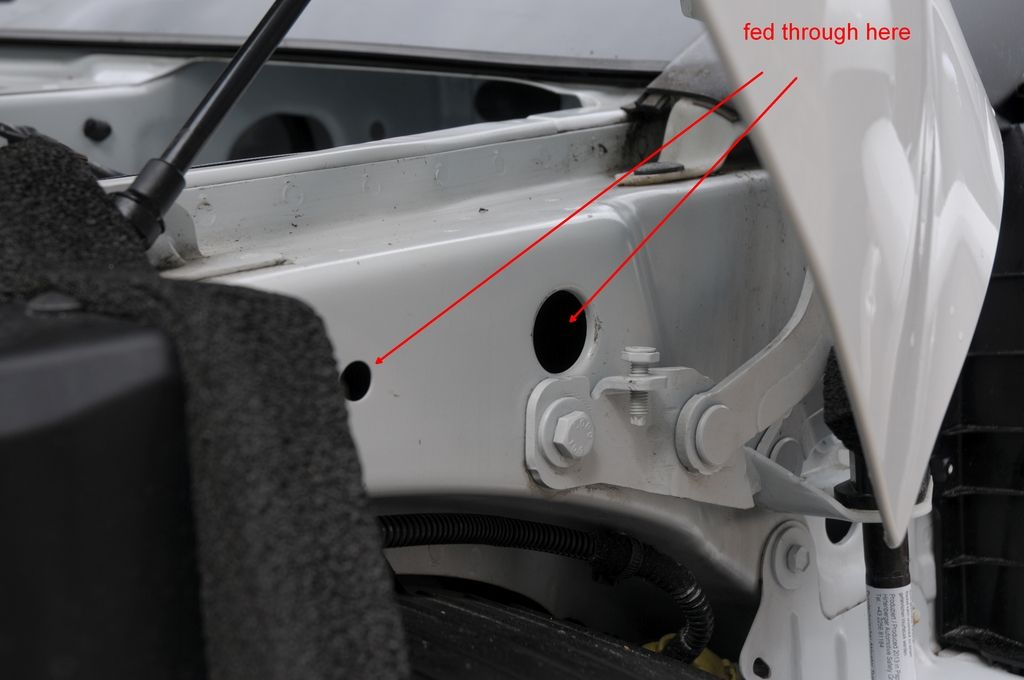

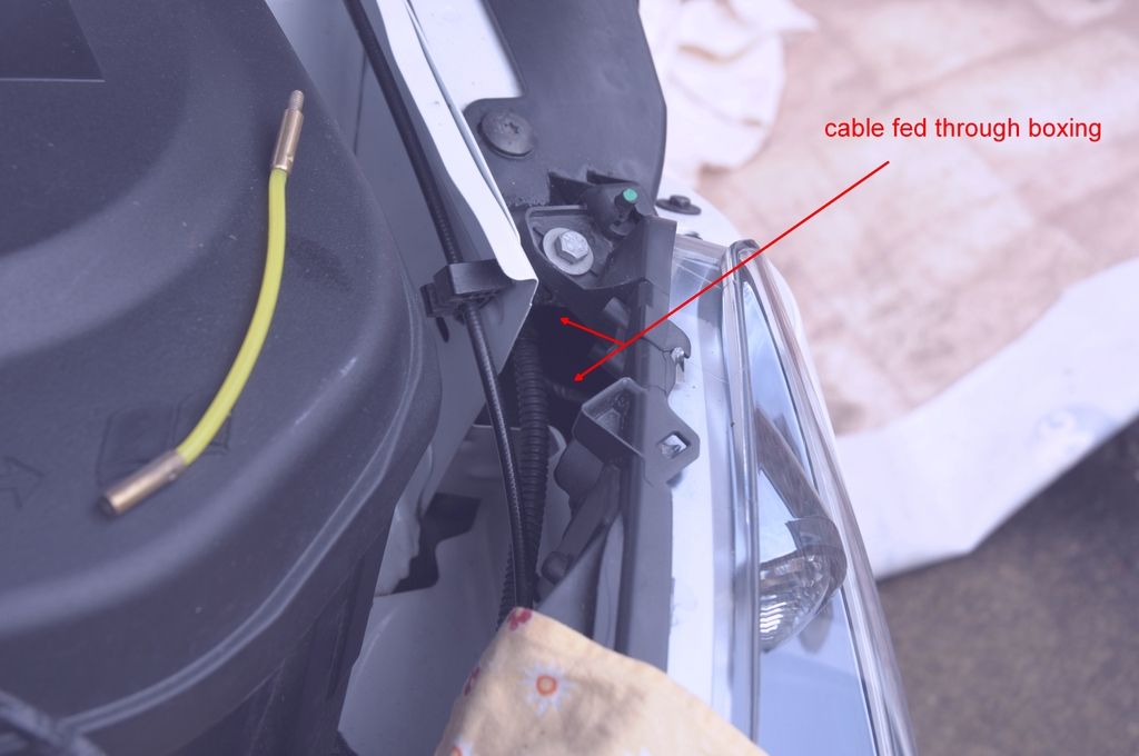

once wiper motor removed its easy access to the rubber grommet for entry through firewall

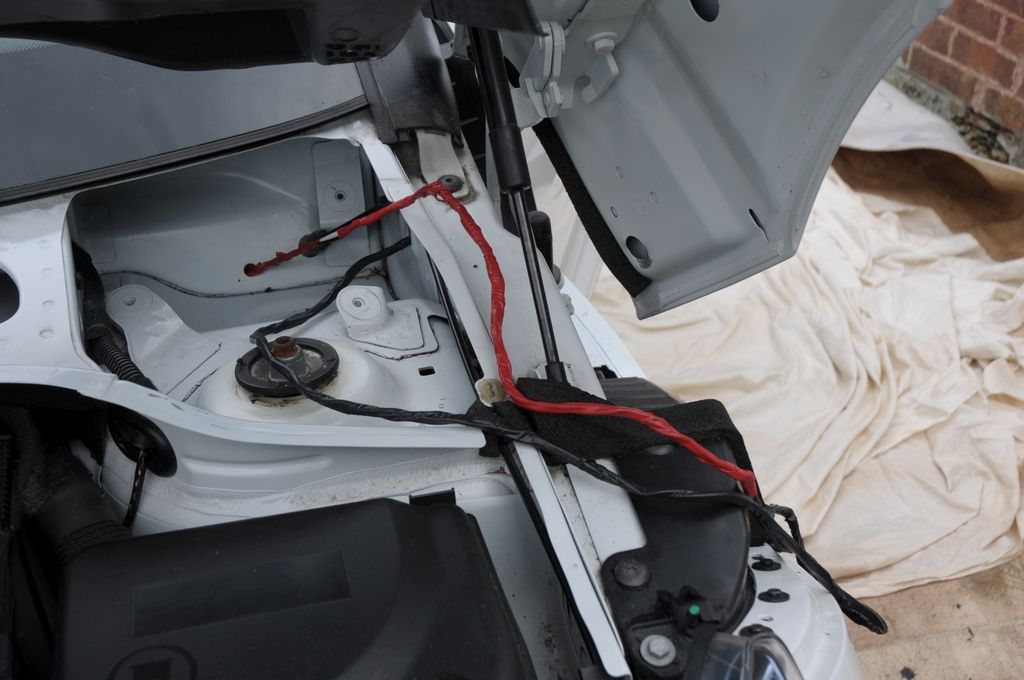

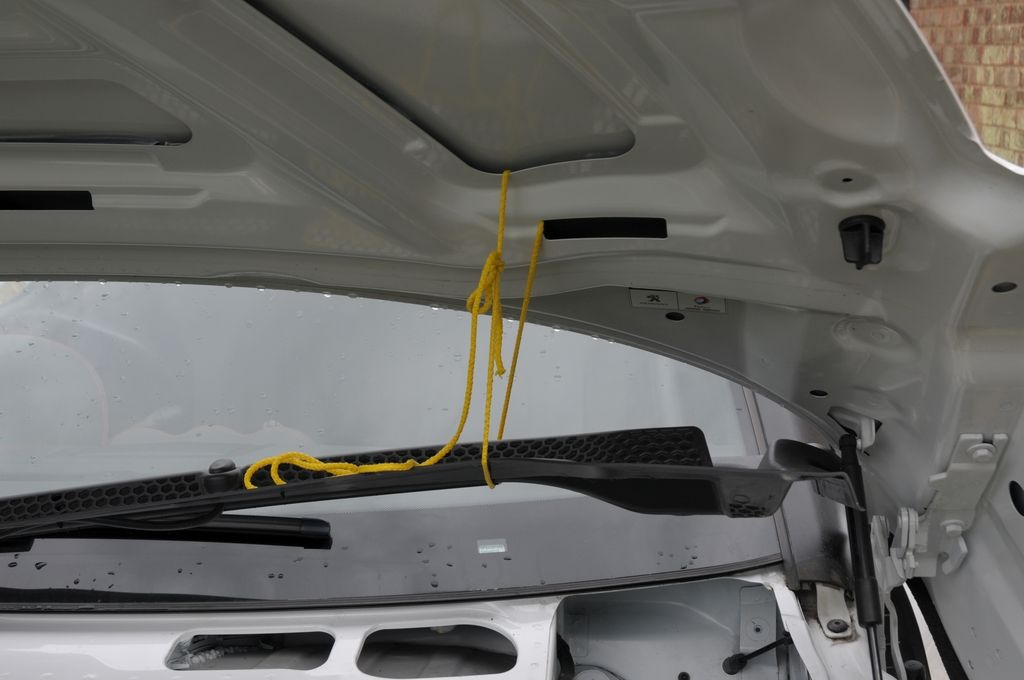

tying this up out of the way - helps

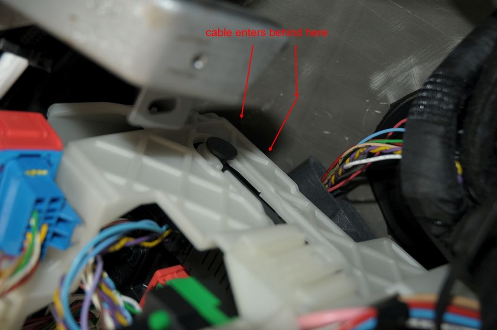

cable enters somewhere here - you can't see exactly
this is what happens if you try pull from the first indent, make sure to connect to the very bottom of the arm

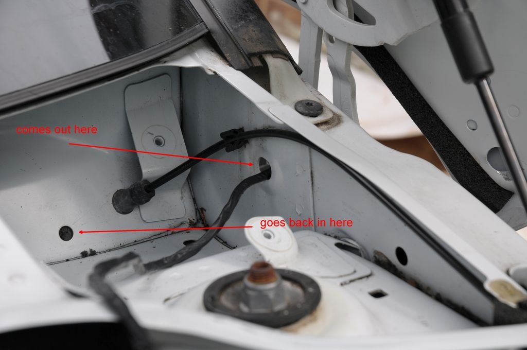

getting the cable through
and eventually

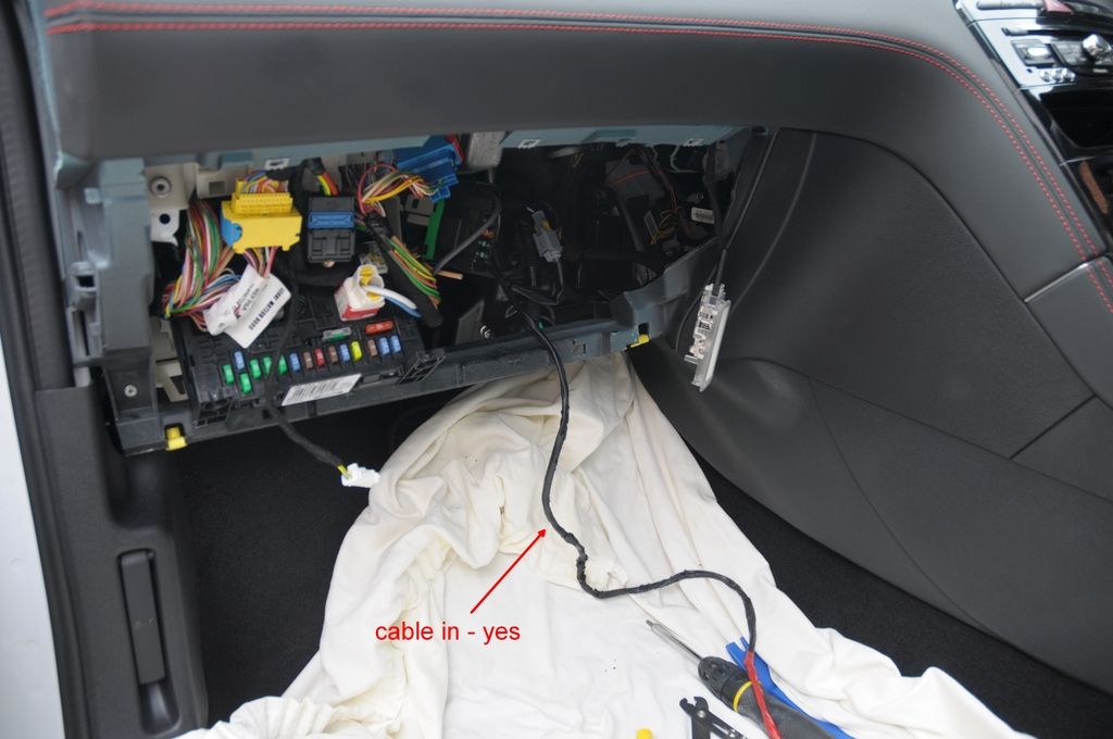

getting the cables through is not easy, it feels as is something is stopping it - it is - the soundproofing and firewall, gently push with some steady controlled force and you should be ok
cables in the car - yeah

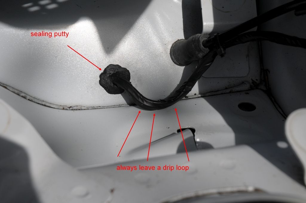

Make sure to put a drip loop to stop the water flowing down the cable and into car, the loop collects the water and it drips here instead. Always seal the hole to further stop the ingress of water into the cab

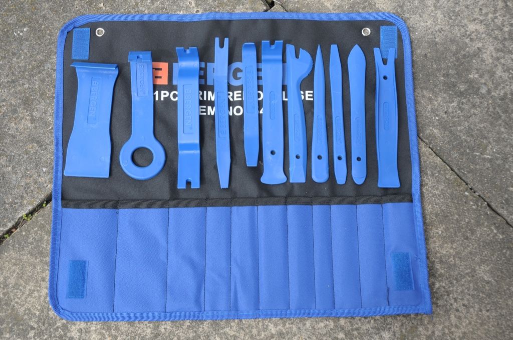

some extremely useful tools for the removal of paneling without damaging them - these were approx £11 for the set

AEK the cables you see me feeding into the car through the firewall - these were for the aftermarket sensor system, as shown with the little black box and yellow sticker.
If you were fitting factory fitted sensors from another car - it is easy. The control box for both front and rear sensors is located in the boot. If it only has rear sensors then the ECU in the boot does not have the white connector on it, but the wiring has the connector behind the box. All you need to do is unplug the old ecu and plug the new one in which has the white connector ( this ECU is for front and rear sensors ). The actual sensors fitted in the front bumper, connect to the wiring harness which feeds your r/h side daylight running light and the motor for the headlight washers if fitted, and it sits attached to the bumper with a dummy plug on to stop water ingress. After that you will need to reprogramme the BSI / audio system for the displaying of the front sensors.
You do not need to run any cables anywhere, they are already in the harness not connected. Always check first before buying another front bumper or the sensors from another Z.
