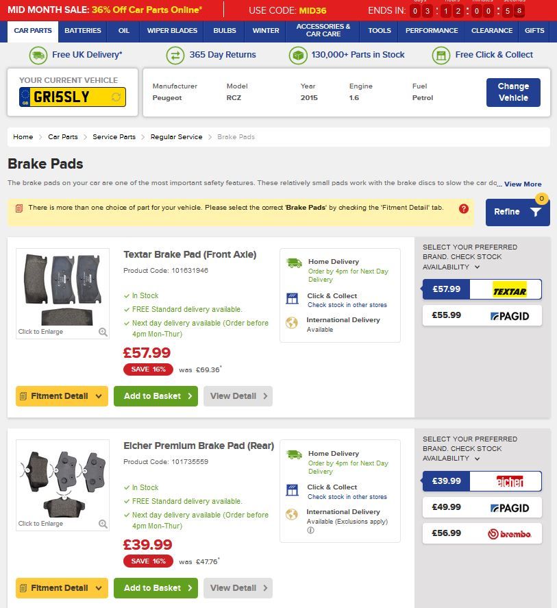

As for the link, I put my number plate into the search on Europarts and this is what it came back with;
https://www.eurocarparts.com/brake-pads
Previously when I have had squealing brakes I have just cleaned them, but as I was told that Peugeot accept there is an issue with these and will replace, I thought best let them do that then, especially since they are so expensive. This way I have maybe another two years or more before similar issue, and then I will be out of warranty.
Interestingly I did give the R a real workout when in Austria, and I cannot fault the brakes, I have never said anything negative about them, but once after coming down from the Stelvio with plenty of Gusto, I did notice some fading, and yes when I got back my brakes were knocking and popping as they cooled down - they were very hot ! :D
Anyway if anyone knows where you can buy similar discs, it might be worth posting this for use next time !!

The pads you linked to look like they could fit the Alcon calipers.
I have part-worn Ferodo pads lying around in the shed so I will check with them and get back to you all here. I can post some pictures and numbers to compare with.
Nevertheless it is crucial to have the proper material compatibility between a pad and a disc. What could happen is while you put those Textar onto the Alcon and they'd fit, they wouldn't perform at all. Or at least not perform at 100% capabilities of the whole braking system (read: safety). It could lead to disc overheating or in worst case, the pad would crumble under pressure. Those are just allegations but I have seen that happening before on big brake systems.
