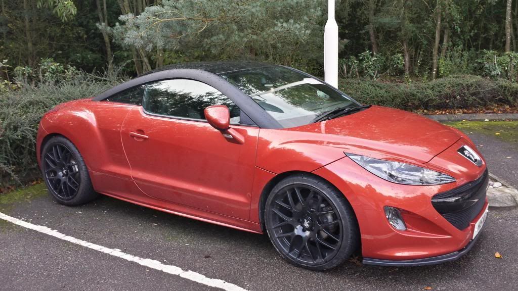

Mine are 255/30 at the front and 255/35 at the back with 15mm spacers :) Theey sit flush with the wheel arches.

I agree there are alot of wheels around with this style, but it suits the car IMO :) Especially now I have black roof arches. And hoy many do you see on RCZs? :)
The main reason is 255/35 doesnt fit on the front without rubbing the arch liners, so I swapped them with 255/30. Since them, I think it looks quite good as the wheel and tyre fill the rear wheel arches quite nicely.
My wheels are 9.5 all round, and I got it like that as I was told 10s would stick out the back too far and 9.5 on the front for the reason stated, more grip.
