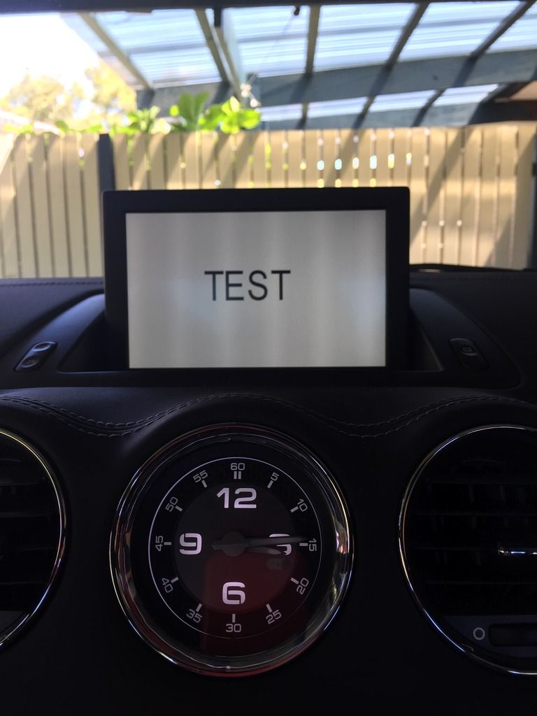

I saw this post last year and got my Moroccan Red gt200 in April. I've had a few goes at loading my "new cooler bootscreen" but had no luck. It seemed to work with no errors but just displayed a black screen.
I finally solved the problem. The jpeg was the right size. I noticed that the original bitmaps as found in the "sauveguarde" folder are 256 colour. A jpeg is 24million regardless of how many are actually used. I made a test jpeg in just black and white. See below..

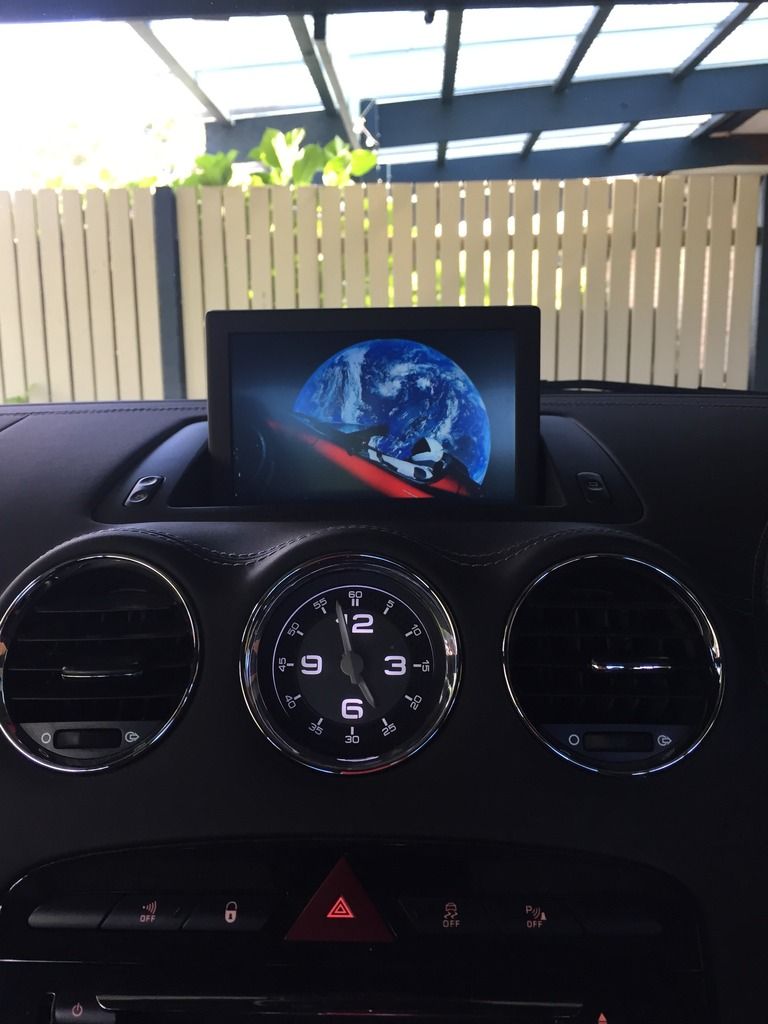

It worked! So I got my desired jpeg (about 90000 colours), saved it as a 256 colour bmp, saved this bmp as a jpeg (now using 256 of 24 odd million) and followed the procedure again.
Voila! New Cooler Bootscreen! See last photo.
